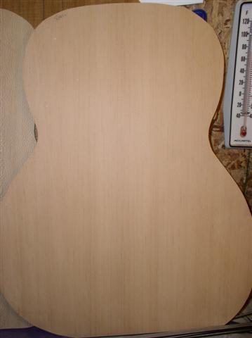

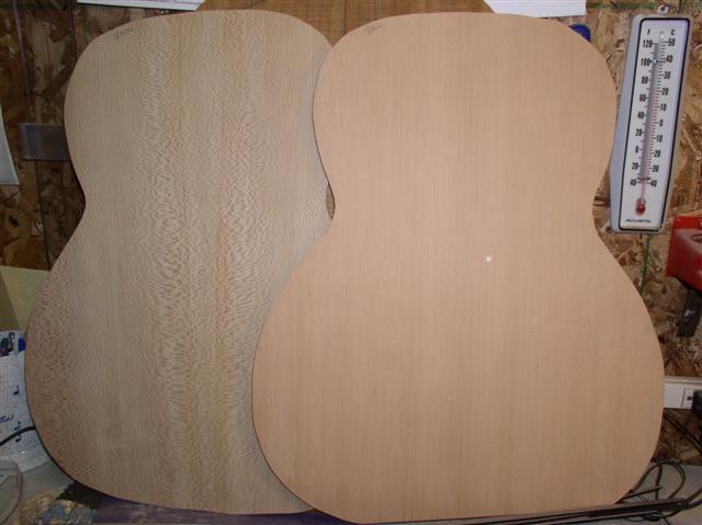

I wish I could comment further on Dug Fir, but I am in the process of building my first from it, and only as a top wood. I can say that it is very stiff along the grain, and has a nice ring, also the color (beige/tan) looks real nice. I'm pairing it with a set of Sycamore with a walnut neck and Tx ebony bridge/fretboard and overlay. So this will be my first all domestic wood guitar.
